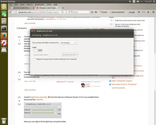

The brightness control bar is not in the system settings of Ubuntu 14.04. How to get it there?
Currently I have lowered the brightness of my desktop due to this wonderful solution, but I still want to know how to get it back in that window shown int the screenshot!

First, open terminal by pressing Ctrl+Alt+T and execute following command:
gksudo gedit /etc/default/grub
Navigate to 11th line, there will be GRUB_CMDLINE_LINUX_DEFAULT="quiet splash" line. Add acpi_backlight=vendor next to quite splash so the line would be:
GRUB_CMDLINE_LINUX_DEFAULT="quiet splash acpi_backlight=vendor"
Save the file, then run update-grub command to apply change you have made:
sudo update-grub
Finally, restart your system
