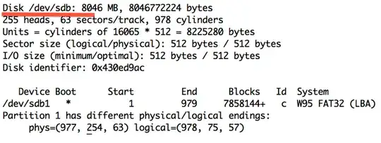

  • use fdisk -l to find the USB device
  • So in our case it's /dev/sdb, because it's 8GB (8046MB)
