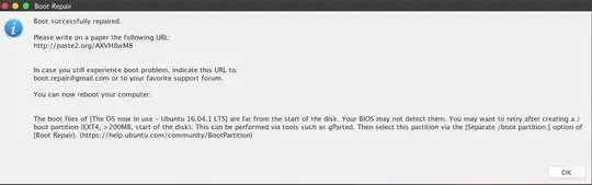

Then I again executed boot-repair and this time it gave me the following result...
result of boot-repair

What happens if you mount all your hard drives and run sudo update-grub?
As your paste2.org file http://paste2.org/AXVH8wM8 tells:
update-grub
Generating grub configuration file ...
Found linux image: /boot/vmlinuz-4.4.0-47-generic
Found initrd image: /boot/initrd.img-4.4.0-47-generic
Found linux image: /boot/vmlinuz-4.4.0-45-generic
Found initrd image: /boot/initrd.img-4.4.0-45-generic
Found linux image: /boot/vmlinuz-4.4.0-43-generic
Found initrd image: /boot/initrd.img-4.4.0-43-generic
Found linux image: /boot/vmlinuz-4.4.0-38-generic
Found initrd image: /boot/initrd.img-4.4.0-38-generic
Found linux image: /boot/vmlinuz-4.4.0-36-generic
Found initrd image: /boot/initrd.img-4.4.0-36-generic
Found linux image: /boot/vmlinuz-4.4.0-34-generic
Found initrd image: /boot/initrd.img-4.4.0-34-generic
Found linux image: /boot/vmlinuz-4.4.0-31-generic
Found initrd image: /boot/initrd.img-4.4.0-31-generic
Found linux image: /boot/vmlinuz-4.4.0-24-generic
Found initrd image: /boot/initrd.img-4.4.0-24-generic
Found linux image: /boot/vmlinuz-4.4.0-22-generic
Found initrd image: /boot/initrd.img-4.4.0-22-generic
Found linux image: /boot/vmlinuz-4.4.0-21-generic
Found initrd image: /boot/initrd.img-4.4.0-21-generic
Found linux image: /boot/vmlinuz-3.13.0-85-generic
Found initrd image: /boot/initrd.img-3.13.0-85-generic
Found Windows Boot Manager on /dev/sda1@/EFI/Microsoft/Boot/bootmgfw.efi
Adding boot menu entry for EFI firmware configuration
NTFS signature is missing.
Failed to mount '/dev/sda6': Invalid argument
The device '/dev/sda6' doesn't seem to have a valid NTFS.
Maybe the wrong device is used? Or the whole disk instead of a
partition (e.g. /dev/sda, not /dev/sda1)? Or the other way around?
mount /dev/sda6 : Error code 12
mount -r /dev/sda6 /mnt/boot-sav/sda6
mount -r /dev/sda6 : Error code 12
Unhide GRUB boot menu in sda2/boot/grub/grub.cfg
Boot successfully repaired. You can now reboot your computer.
It seems that there is something wrong with your Windows mountpoint. You could try to remove the BIOS Boot partition on sda6 and repair Windows with its built in tools. Then, using a live DVD, you could repair your Grub again.
