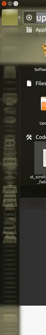

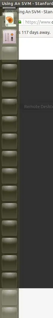

The other day I noticed one of the icons in the left dash was missing. Today I noticed most of them are missing. What causes this, and could the miniSSD be going bad?
I have Icon-theme set to Human (the old icons) using Ubuntu Tweak Tool on 14.04 but this setting hasn't caused this issues for months now.
The home (on a hdd) is encrypted and maybe there is an error in reading it, as I see this in the system log:
compiz: pam_ecryptfs: seteuid error

You can check /usr/share/icons to see if all icons are present.
Further you run following commands:
[1] This will reset the Unity Launcher icons to their initial state:
unity --reset-icons
[2] Then you need to reset the Unity Settings in order to eliminate any unknown discrepancy. This will not affect any of your other CCSM settings.
unity --reset
Reboot the system and hopefully your problem will be solved.
It seems this is the intermittent graphical glitch in Linux 4.3-4.4 described various places, not just Ubuntu. You can install Ubuntu's older 4.2 version to fix it:
