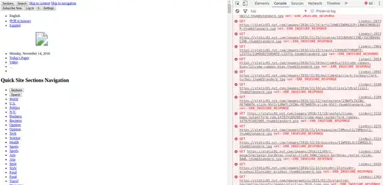

I installed ubuntu 16.04 several weeks ago. Recently (in the past few days), several websites have started displaying incorrectly, i.e. without images or CSS stylings.
For example, here is nytimes.com:
nytimes
Output from chromium-browser --version:
Using PPAPI flash.
Chromium 53.0.2785.143 Built on Ubuntu , running on Ubuntu 16.04
What should I do to fix this? I tried clearing cookies and disabling all extensions, but the problem persisted.
I have the same problem on certain other websites (e.g. wellsfargo.com), but not all (e.g. askubuntu.com displays correctly). On wellsfargo.com, I see the same sort of Failed to load resource: net::ERR_INSECURE_RESPONSE messages in the developer tools console.
This problem does not appear when I use firefox -- it only affects chromium.
Edit: I uninstalled chromium, rebooted my machine and reinstalled chromium, and the problem persists...
Edit: on both nytimes.com and wellsfargo.com I see Failed to load resource: net::ERR_INSECURE_RESPONSE not only for images but also for the page's css, which explains the lack of stylings. On wellsfargo.com, for example, GET https://www01.wellsfargomedia.com/css/home/homepage.css fails with net::ERR_INSECURE_RESPONSE.

It's a known bug:
The bug has been squashed upstream, and they say that "the updated package should be released soon".
Edit to update status "This bug was fixed in the package chromium-browser - 53.0.2785.143-0ubuntu0.14.04.1.1145" (source: https://bugs.launchpad.net/ubuntu/+source/chromium-browser/+bug/1641380)
