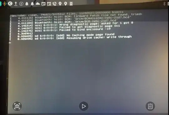

In my case, I have a duel boot with Windows 10 and Ubuntu 20.04 on a SSD, and my Ubuntu "Home Directory" on a large hard drive, partitioned half for the Windows OS storage. After reading some info and a bit of fumbling about, I found an error showed in the sdb1 drive.
I was able to run fsck -y /dev/sdb1. I don't know why, (I am just a average user), but that command moved my entire "Home Directory" to a hidden "lost and found" folder. I was able to boot up Ubuntu but the OS was as if I was booting for the fist time. My desktop was gone and nothing worked. I couldn't open the home directory, or anything else for that matter. I couldn't even shutdown or reboot. Next I booted with a live Ubuntu 20.04 thumb drive and found the home directory not showing in the storage drive. I hit control+h to see the hidden lost and found folder. Inside that I found my entire home directory, yeah so that was a relief. I reinstalled Ubuntu 20.04. I used the same username and password as the first time I installed. After the install restart, the machine booted with the fresh Ubuntu OS. Then I updated the system and rebooted. So far so good. Then I recreated the home user folder and copied the data back as it was before.
Fortunately for me I had the "Time Shift" directory on a separate partition, and three most recent image snapshots were in tact. So I installed "Time Shift" and it was able to restore my OS from the most recent image snapshot. The machine automatically restarted after the Time Shift completed it's thing. Unfortunately the machine didn't boot up to the Ubuntu OS. I just got the "Dell" logo.
Next I booted from a USB Linux Mint live OS. I thought I would need to use "grsync" to copy the user file in the home directory. First, I repeated the same steps I used to move the "Home Directory" to the storage drive (found here) the first time I did that. Then I checked the fstab file. I found the UUID number was not where the new root operating system was, so I replaced the UUID number with the UUID number where the new root OS folder (and saved the file). Then I restarted the machine. The machine booted and my old desktop was there. WOO! HOO!
I ran an apt update && apt upgrade -y command, no problem. I restarted and booted into Windows, no problems. Restarted and booted up Ubuntu, there were a few errors that flashed on the screen for about two seconds (see attached photo)photo of errors before the boot into Ubuntu 20.04 then the machine booted normally into the Ubuntu OS.
Now a couple of programs need to be reinstalled (notepaddQQ and TradingView don't open). Also, the "settings menu" would not open. I was able to reinstall the notepaddQQ, tradingview, and restore the settings menu. Other than that, I am quite pleased I got my machine back!
