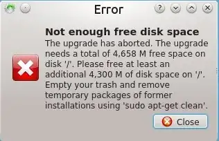

I'm trying to update my distribution and get the following error:
Error message

Any help will be much appreciated Thanks
