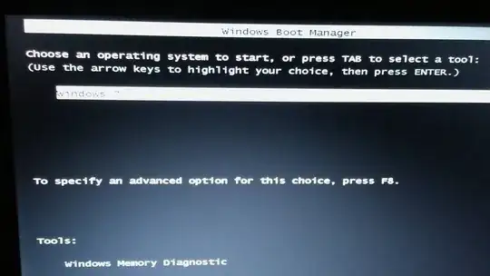

I just purchased a refurbished Lenovo T420 with pre-installed Windows 7 Professional and am trying to install Ubuntu 16.04 from a USB flash drive. Apparently, the machine is not using the familiar BIOS but something called "Windows Boot Manager" so I don't see the familiar screen in BIOS where one gets to change the order of boot devices and chose to boot from the USB.
Instead, when I press F2 during restart (with the USB flash drive inserted), I am presented with the following screen:
… so I am not allowed to install Ubuntu and my only option is to start Windows 7.

This Lenovo support site states you need to press F1 or Enter to invoke BIOS setup at the startup. F2 does not work nor does "ThinkVantage" key.
