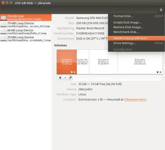

Have you tried running Ubuntu from a live USB stick and tried to access the files on the broken drive? Have you tried some diagnostic tools like the SMART data & self tests of the Ubuntu disk utility when running from live USB. It can be found by typing Disks in the dash. enter image description here

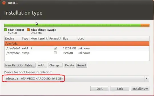

If the broken HDD is still connected and can be recognized by Ubuntu you have to pick the 'Something else' option from the installer. Then you just select your external HDD for bootloader installation from the dropdown menu seen in the image (note: your external HDD will not be /dev/sda. See which descriptions matches your drive) enter image description here
Delete any existing partitions on it (everything under /dev/sdX where X is the letter of the drive you've selected for bootloader installation) and add a new partition on it consuming all unallocated space.
