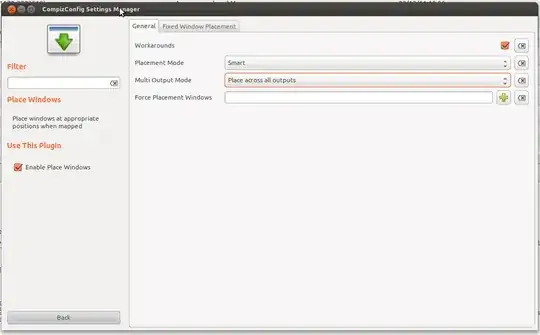

If only have two monitors linked on twinview, but I use to have similar problems with the compiz defaults. Here's how I solved it, and I think it should work for you:
Install CompizConfig Settings Manager sudo apt-get install compizconfig-settings-manager and run it using ccsm.
In the list of options find Place Windows in the Window Management section.
Change the Placement Mode to Smart and the Multi Output Mode to Place across all outputs.
