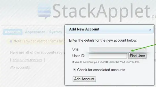

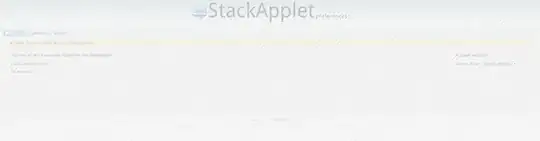

The screen after pressing Add a new account: enter image description here
The screen should look like this: enter image description here
