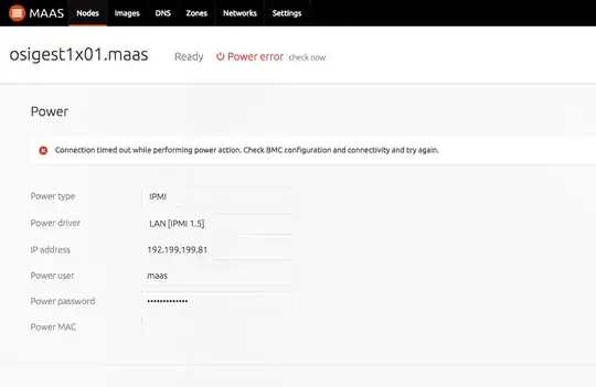

I am not able to power on/off all the node from an IBM blade server HS21 XM. Everytime a blade boots from network, maas assign to its BMC card an ip 192.199.199.8x that I think is not available in my network. When MAAS try to connect through IPMI I get the error
Connection timed out while performing power action. Check BMC configuration and connectivity and try again.
This is the screenshot from MAAS:
MAAS
This is the BMC setting:
BMC setting in BIOS
How can I manage through MAAS these blades? Maybe the problem is in the configurated IP for the BMC. How can I change permanently this IP? Obviously, if I choose manual power type I am able to get a node "Ready", but this is not what I want. Could you please help me?

Do you have enable Serial over LAN on IPMI configuration ?
MAAS Server need SoL access to communicates with IPMI.
