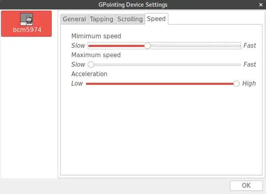

Current mouse/trackpad settings can be set with gpointing-device-settings or in /usr/share/X11/xorg.conf.d/60-libinput.conf.
gpointing device settings
