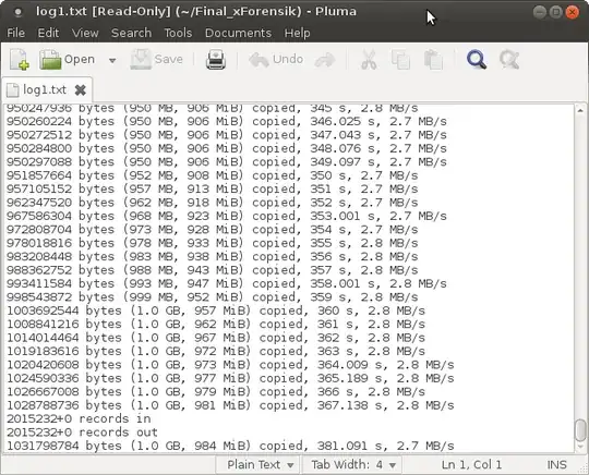

I've seen people giving this suggestion all the time; putting 2>&1. But this will only display the progress in the log.txt file and the terminal will display nothing. Here's a picture of what the progress look like on the log.txt file.
logfile

The progress is output to STDERR rather than STDOUT. You could get something like what you want by doing tail -f on the file being written to like this:
mate-terminal --geometry=50x10 -x sh -c 'tail -f log.txt'
sudo dd if=/dev/sda of=/dev/sdb status=progress 2> log.txt"
tail -f log.txt will print everything being written to log.txt to the new smaller terminal and run as a background process so you can issue more commands while it runs.
2> sends STDERR stream to log.txt. If there is any output on STDOUT it will display in the terminal from which the command or script is run.
