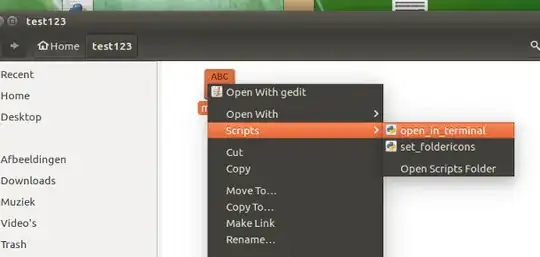

  2. Copy the script into an empty file, save it as open_in_terminal (no extension) in ~/.local/share/nautilus/scripts. Create the directory if needed. Make the script executable
That's it. Log out and back in and you'll have the script available as in the image (2).

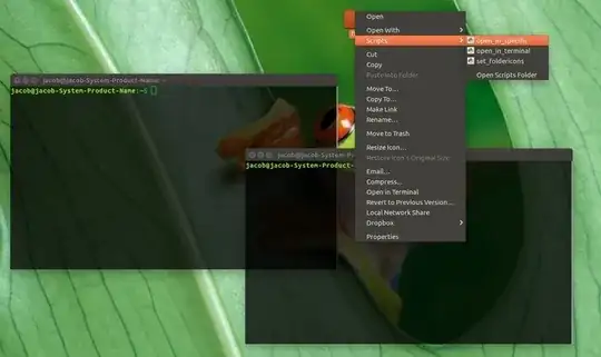

If you want to be able to choose in which terminal window you would open the current (nautilus) directory, use the script below.
How it works in practice

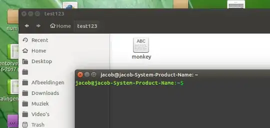

  1. Right- click (any) file inside the directory (in this case my desktop) like below:

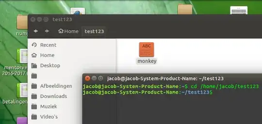

  2. Click on (or raise otherwise) the terminal window you'd like to use, and it will cd to the directory:

The script has one difference from the first one: instead of automatically raising the first found terminal window, it waits for the first terminal window to have focus. Then it cd's to the directory inside that window.
