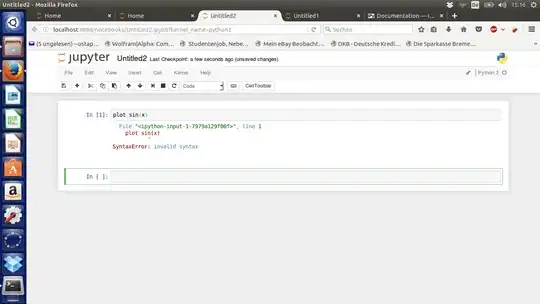

My teacher plotted some functions with Jupyter Notebook or IPython. I have installed Jupyter Notebook and have the home screen, but how can I plot a function?
I have already tried: plot sin(x) but I get this message:
  File "<ipython-input-4-7979a129f00f>", line 1
    plot sin(x)
SyntaxError: invalid syntax
Screenshot

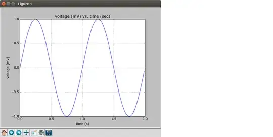

  5. Your output plot will appear in a small popup window that looks like the popup window in the below screenshot.
output plot

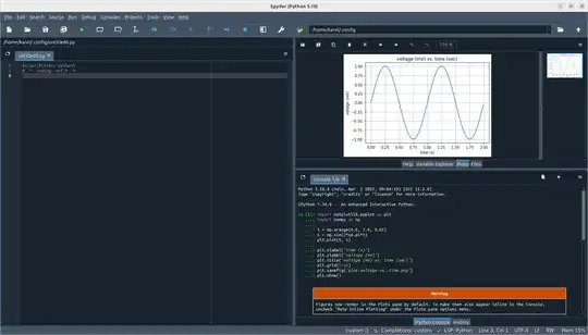

This is a screenshot of another way to run the same code in Spyder 5.3.1 in Ubuntu 22.04.
