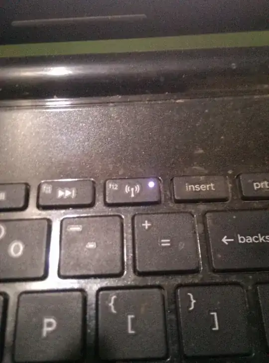

When I open the connection setting then I press
"wifi key" , airplane mode switches on and off. When I switch the wifi toggle on wireless network, it turns off again, I mean I am not able to turn on the wifi.

First go into BIOS and reset it to defaults. If that does not help, then run in terminal
sudo tee /etc/modprobe.d/blacklist-hp.conf <<< "blacklist hp_wmi"
and reboot.
