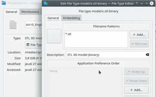

Regarding the iso file, I do not know why xdg-mime is telling you model/x.stl-binary. On my computer, it reports application/x-cd-image. Also, using file without the --mime-type flag reports additional information that confirms it is some type of disk image. Perhaps it would be helpful to update the mime database:
sudo update-mime-database /usr/share/mime

If you need the mime type to have a context menu action with some file manager like Nautilus or Dolphin, look in that file manager under the file's "Properties".
In Dolphin:
