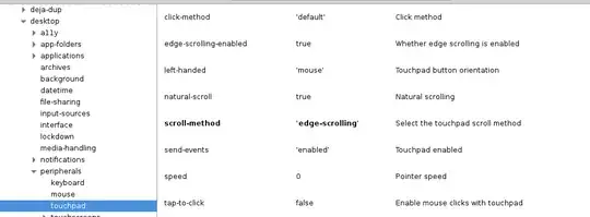

I looked under
org > gnome > desktop > peripherals > touchpad
and the settings were available. But the scrolling parameter was already set to edge-scrolling (see image below), but it does not seem to work.
