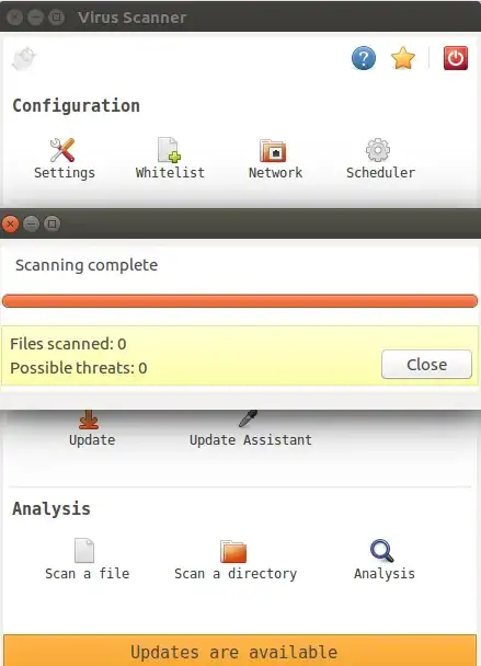

and i am unable to scan anything. Whenever i try to scan it completes within 1 second and I get this:
Screenshot
which shows 0 files scanned,but i selected a directory and scanned it.Where is the problem?I had also tried updating Clamtk using command sudo freshclam but it shows this error

The clamtk settings may not be selected correctly. By default, some settings may be disabled and you may have to activate them as below. Please check Configuration -> Settings menu for the items below and activate them by ticking/selecting;
  • tick -> scan files larger than 20 MB
  • tick -> scan directories recursively
The ClamAV configuration file is probably still the default bundled with the the installation. To fix this error you have to:
  1. Rename /usr/local/etc/freshclam.conf.sample to freshclam.conf and edit the line with the word Example to #Example. AND
  2. Rename /usr/local/etc/clamd.conf.sample to clamd.conf and edit the line with the word Example to #Example.
