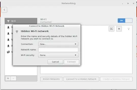

Using the Network Manager GUI I can "force" a connection to a specific wireless network using "Connect to a Hidden Network". Even if NetworkManager hasn't yet detected a particular SSID, it will try (and succeed) at connecting to the indicated network:
networking menu
