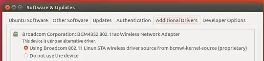

I have selected bcmwl-kernel-source from the additional drivers application:
