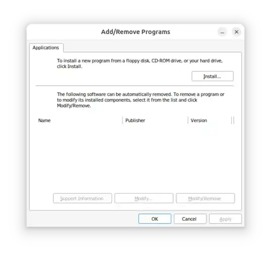

Do the following to install wine-mono:
  1. Download wine-mono.msi from the official WineHQ site.
  2. Type wine64 uninstaller to launch "Add/Remove Programs": Screenshot
  3. Press "Install" from the uninstaller GUI and select the downloaded .msi package.
  4. Done!
