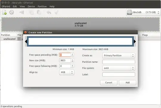

1. Creating a Partition
To create a partition, click on the Partition menu of the Gparted window and Choose "New"
after doing so just click on add on the next windows that pops up.
then go to the "edit" menu of the gparted window and click on "Apply All Operations" then follow that with a click on "Apply" on the confirmation windows that pops up next. You now have a partition table, a partition and a filesystem. To mount the filesystem, you can just click on the new "100 GB Volume" addition to the left hand side of your file manager's window.
