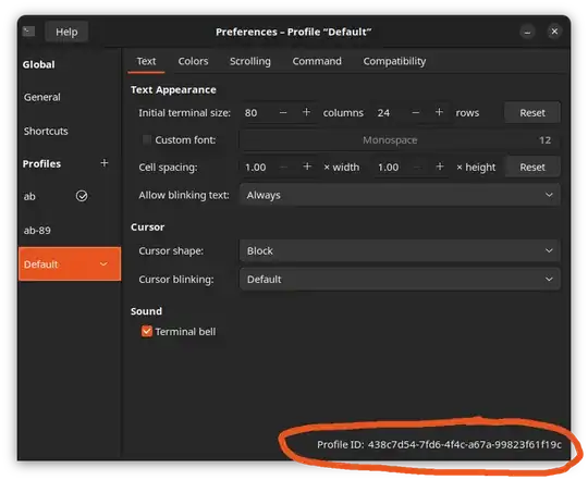

Find your GNOME Terminal profile's UUID:
menu -> Preferences -> select your profile -> find the Profile ID listed in the bottom right
Your UUID might look like b1dcc9dd-5262-4d8d-a863-c897e6d979b9.
gnome-terminal preferences

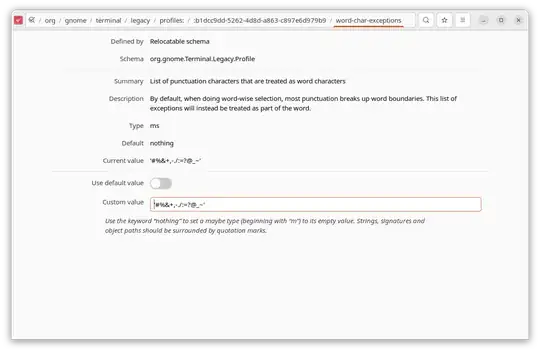

Then open dconf-editor.
  • Navigate to /org/gnome/terminal/legacy/profiles:/.
  • Go to your profile's UUID
  • Go to word-char-exceptions
  • Set your custom value (must be surrounded by quotation marks)
dconf-editor showing word-char-exceptions
