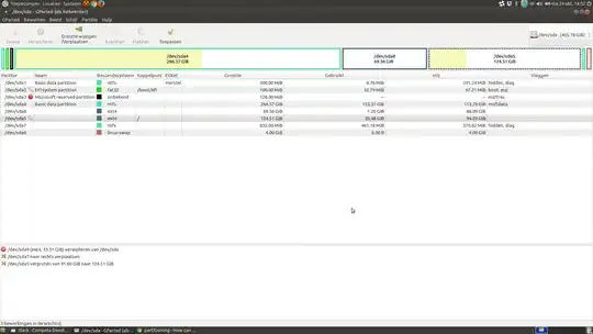

I have the following partitions
enter image description here I have no problem translating the image, as it is in Dutch, but it should be self-explanatory.
I want to merge /dev/sda8 with /dev/sda5 without losing data from /dev/sda5
I've looked around but could not find a good answer.
As you can see, sda8 is not mounted and it's contents can be lost no problem.
When I remove that partition and try to move sda5, it won't let me. I can't move that partition to the left for some reason.

As oldfred pointed out:
You have to use live installer. You cannot modify mounted partitions & little key icon says it is mounted. I do not like moving left as any interruption power failure, impatient user, etc totally corrupts it. So have good backups. I prefer to have smaller system partitions like 25GB and larger /home or data partition(s). I use a data partition, but newer users find setting up /home easier. Question #743095
