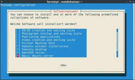

I recommend to follow the other answers, usually research is a good idea.
But you're just looking for ways to add basic functionalities like various servers (such as web, database, mail etc), different Desktop Environments tasksel can be a good option as well. tasksel let's you select tasks like "Mail server" and installs the necessary default packages for that task.
sudo apt-get install tasksel
sudo tasksel
Check the screenshot for of a tasksel waiting for selection
Tasksel screenshot
