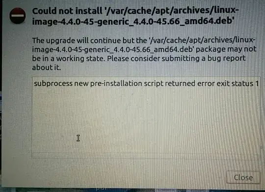

Got another warning -- don't know whether this is related to the earlier problems:
