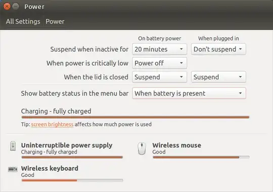

For others reading this answer keep in mind from the Launcher select System Settings and click the Power applet and make sure it is also be configured like this:
Power Suspend
Notice the When lid is closed section. Have the options set to Suspend. If either these Power settings or systemd's settings above are set to ignore then suspend will not occur.
