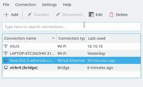

Few days ago I had to connect to Internet through PPPoE and I used pppoeconf. Now I came back to dhcp. But whenever I make a new wired connection with NetworkManager it doesn't get able to connect with, like this:
wired connection error
If I try to connect through nmcli:
sudo nmcli connection up New\ 802-3-ethernet\ connection
Error: Connection activation failed: No suitable device found for this connection.
dhclient doesn't works too.
But if I reboot my laptop with Ethernet cable plugged in it works properly (while cable doesn't plug out and in again).

From here I got that any interface listed in /etc/network/interfaces are not managing by NetworkManager, so I just deleted enp3s0 interface from this file and that is works.
/etc/network/interfaces looks like this now:
# interfaces(5) file used by ifup(8) and ifdown(8)
auto lo
iface lo inet loopback
