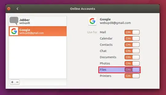

This is the solution that worked for me (source):
Install GNOME Control Center (GNOME System Settings) and GNOME Online Accounts:
sudo apt-get install gnome-control-center gnome-online-accounts
Open the GNOME Online Accounts:
gnome-control-center online-accounts
From there add your Google account and make sure "Files" is enabled:
GNOME Online Accounts window
You should now be able to access your Google Drive files from the Files (Nautilus) app which appears alongside other mounted drives and, in my case, is named with my email address.
