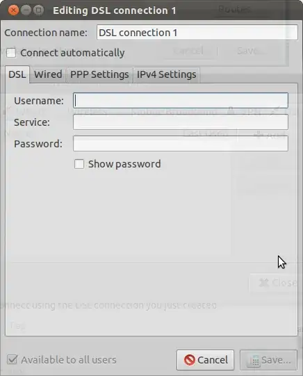

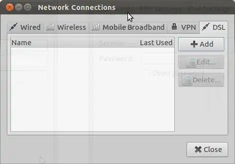

You have two options for PPPoE as I understand from your question.
Option 1
DSL provided by Network Manager. Just go to Edit Connections… in the Network Settings and you will see DSL on the last tab and Add the connection.
Network Connections overview DSL connection configuration

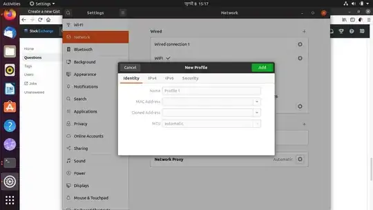

If someone looking for the PPPOe setup for Ubuntu 20.04LTS , h may not find that option in Setting>Network as i have given a picture of my Ubuntu 20.04!
There is no option for DSL/PPPOe and i don't know why!
You can create using these commands :
nmcli con edit type pppoe con-name "interface_name"
set pppoe.username isp_provided_username
set pppoe.password isp_provided_password
save
I solved this problem by setting up a DSL Connection.
  1. Make sure your wired network, is set to automatic DHCP.
  2. Create a DSL Connection.. and provide your username & password. (For me, I didn't had to change any of my PPPOE Settings)
  3. Save the Connection
  4. Connect using the DSL connection you just created

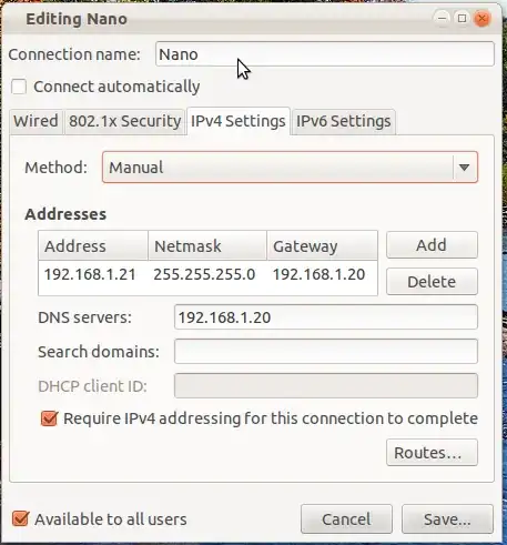

Setup a manual Ethernet connection ..
Try the instructions for Mac OS-X (page 4.) for the IP address settings.
http://www.ubnt.com/downloads/Nano_Quick_Set-up.pdf
best guess on these settings for Ubuntu: (and you should enable 'Connect automatically')
