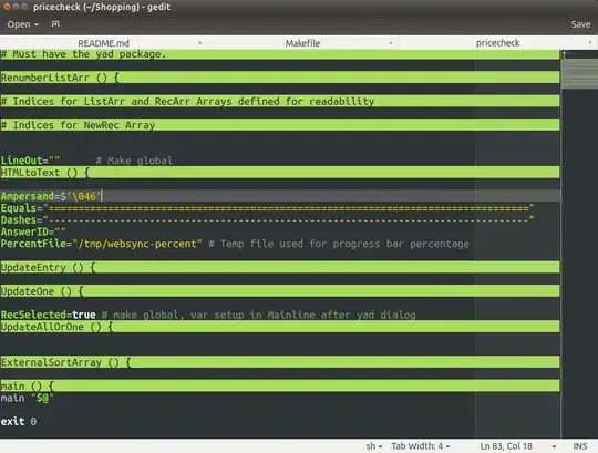

It took 919 lines of bash code and folded onto one page. It helps me spot constants I need to move into functions. It also made me realize some functions need to be broken down into smaller chunks:
Note: To install it I had to first create the directory
/home/myname/.local/share/gedit/plugins
Then change to that directory and run
git clone https://github.com/aeischeid/gedit-folding
Next use gedit's menu Edit -> Preferences -> Plugins -> Folding
I only wish I new Python (it's only 174 line program) so I could modify it to save folded code marks and reapply them when file is reopened. I can see now I'll be keeping the same file open for 2 weeks :)
