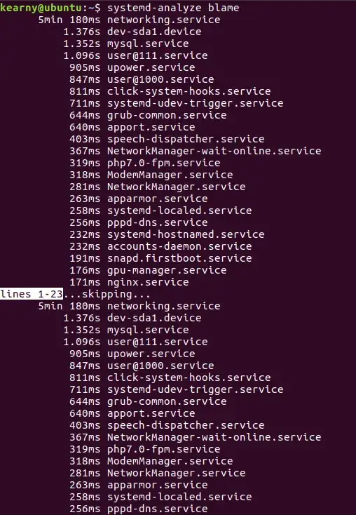

According to systemd-analyze blame, networking-service is taking over 5 minutes to start at boot:
Why is this happening and how can I fix it?
