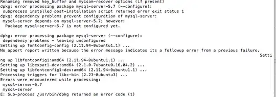

I was just trying to install some package through apt-get, then I got a message saying dpkg is broken and I need to manually run suo dpkg --configure -a, so I did and this is what I've got enter image description here
It is just stuck there and won't return to command line.
I press ctrl+c and the program continues and outputs an error message saying :
error processing package mysql-server-5.7(—configure): subprocess installed post-installation script was interrupted
Can anyone explain to me what is wrong and is it critical?

1) I try to do dpkg --congifure -a --force as the error message suggests, but it says --force needs to take a value, so I am stuck again.
2)I try to ignore the problem and resume the installation of the package
sudo apt-get install libfreetype6 libfreetype6-dev
which is in part of a PhantomJS installation. But during the process, there is also some error message regarding mysql, as shown below
After a long pause(around 3 minutes), the process continues and outputs is as below:
I will just be using PhantomJS to scrape some webpages, will these have an impact on my project in the future?

So, after many months with this problem, I finally solved it by doing this:
cd /var/lib/dpkg/info sudo mv mysql-server-5.7* ~/mysql-conf-bk-files sudo dpkg --remove --force-remove-reinstreq mysql-server-5.7
I used the source in the comments, but the link is not available anymore, so I used archive.org to retrieve the info.
