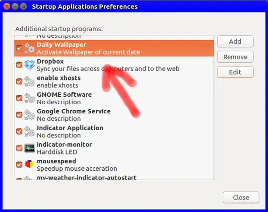

The Startup Applications app is needed if you are not logged in at midnight. The startup app will make the change when you log in. You can find the Startup applications app in the Ubuntu Dash: (Ubuntu Dash -> Startup Applications).
The crontab entry sets the background variable if you are logged in. The Startup Applications app sets the variable if you were not logged in at midnight when the cron ran.
Using the two, the correct day's wallpaper will always show.

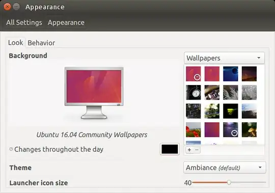

I would use cycling wallpaper:
Then I would use conky to display the day of the week:
