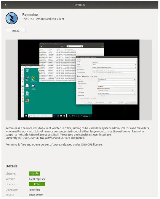

The Remmina developers now maintain a snap in the snap store. You can install the app either from Ubuntu Software (on Ubuntu 16.04 and above) and via the command line (from Ubuntu 14.04).
Installing from the snap store has the benefit that the upstream Remmina developers keep the snap up to date.
Installing from Ubuntu Software
Remmina in the Ubuntu Software Store
Installing from the Terminal
If you're on Ubuntu 14.04, you may not have snapd installed, which provides support for installing snaps. snapd can be installed easily via apt.
sudo apt-get update sudo apt-get install snapd You may need to logout / back in to ensure icons appear in the launcher for snap installed applications.
Installing Remmina is then simply:
sudo snap install remmina
