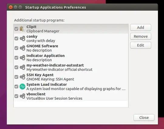

To augment the other answer, if you prefer a GUI approach, simply type Startup in the Dash and click on the Startup Applications icon. This window will appear. (Contents of window will vary from system to system).
Click the Add button, enter a descriptive name and the command into the appropriate boxes. Add a comment if you wish. Then click the add button. The new startup command will appear in the list.
Some applications require a delay before starting, such as ones that depend on the desktop, such as Conky. If your application is one of these, you can add a delay in seconds by adding -p 20 (for a 20 second delay) after your command. Change the number for the delay value you need.
