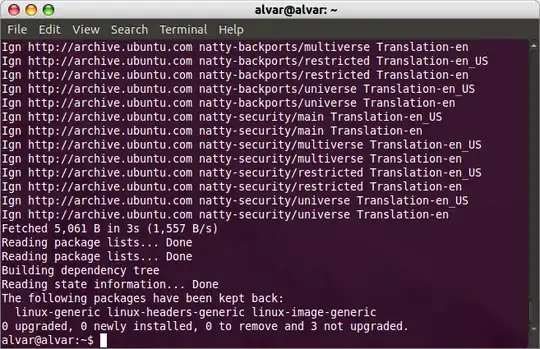

If I type sudo apt-get update && sudo apt-get upgrade I can only see that the kernel packages are kept back, and not installed. As the screenshot shows.

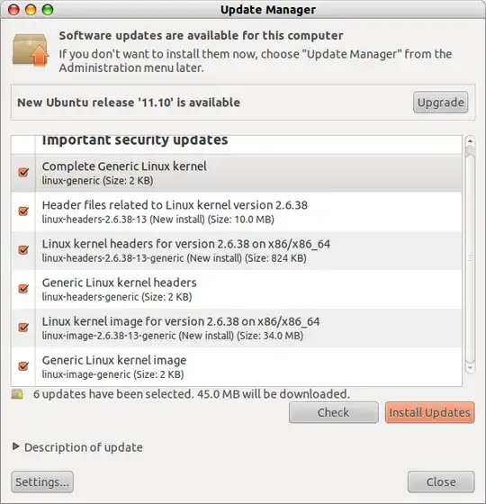

If I then start the update manager I can install the kernel, with no problems at all. As the second screenshot shows.
Why is this?

This is the difference between upgrade and dist-upgrade. The first never install new packages.

This is why!
The kernel is a new package and not an upgrade of an old one, this is why you can't use the command upgrade that upgrades/updates packages. You need to use the command dist-upgrade to install new packages.
When you have updated to the new kernel you can run the old one as well. That's why it's a new package and not just a upgrade.
