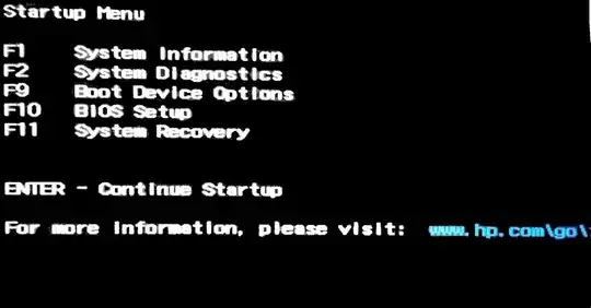

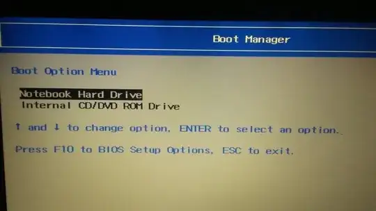

Edit: This is my BIOS screen and my Boot Option Menu. There is only the primary drive.
Boot Option Menu
