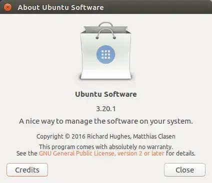

I tried going to the application's menu > About but is doesn't show the actual name of the application there. Here's a screenshot of gnome-software > About, which only shows the published name of "Ubuntu Software". Ubuntu Software > About

Therefore I wasn't able to report the bug, so I came to AskUbuntu. I did a search for "ubuntu software" and saw the name "gnome-software" somewhere.
I opened a terminal, used the command gnome-software, and the correct application started.
I ended up asking a question in AskUbuntu instead of reporting the bug. However, I have had this same problem many times over the last 10 years or so, and I would dearly like to solve it once and for all.
