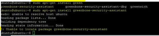

Hoping someone can explain to me what the problem is with the below screenshot?
I recently installed Ubuntu 16.04 server on Raspberry PI and I am trying to install Openvas,
It is not in the repository, you can get it at this PPA
sudo add-apt-repository ppa:mrazavi/openvas && sudo apt-get update
sudo apt-get install greenbone-security-assistant
Here is a list of other packages supplied by this PPA
greenbone-security-assistant9
openvas-cli
openvas-libraries
openvas-manager
openvas-scanner
openvas9-cli
openvas9-libraries
openvas9-manager
openvas9-scanner
rats
