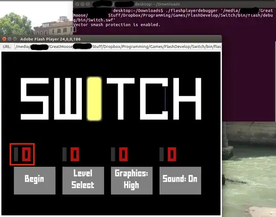

Downloading and running the projector files that you linked worked fine for me. Here's a picture (with my name blacked out):
Image of a flash program running
Either just giving the file as an argument in the terminal or pasting the .swf file's location in the URL bar after executing it worked for me with both the debugger and non-debugger versions.
