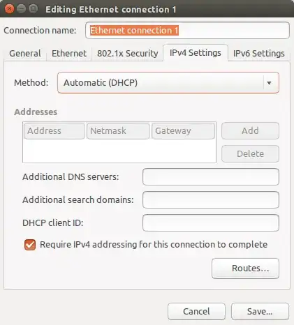

enp4s0f1 (wired interface) doesn't have an IP4 address while wlp3s0 (wireless interface) does. Perhaps this is the source of your difficulty.
Note that this answer is not version/driver specific. Tested under 14.04 with the atl1c driver and 16.04 with the r8169 driver
First insure that network manager is set to receive an IP4 address: Open Network Connections Choose your Ethernet connection and click edit. Change it as necessary so that it looks like this on the IPV4 settings tab: The Method is the important part (the checkbox won't hurt either)
IPV4
Click Save, then Close - Then issue the following commands in the terminal
sudo dhclient -v -r enp4s0f1
sudo dhclient -v enp4s0f1
As an alternate approach you can change the method to Manual and use a static IP address in the form 192.168.185.x (where x is an address on your network not given out by your routers dhcp pool)
