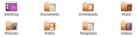

As you may have noticed, Ubuntu has a few "special" folders for certain types of content.
Special directories
These will appear in new user accounts, and auto-recreate (in certain situations) for existing users. However, this behavior can be configured.
