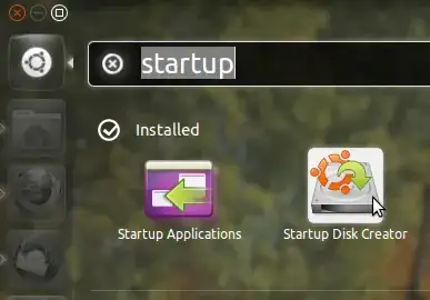

The simplest way to create a Linux install disk (on USB) is to use the 'Startup Disk Creator" application.
Just click on Dash icon (top left), and type startup (then click on icon).
Note: This will overwrite (and erase) any files already on the USB drive. You should use a spare USB stick of 2GB or 4GB capacity.
