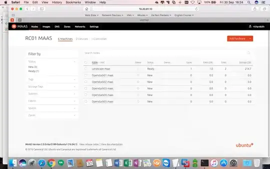

I'm trying to install Ubuntu Openstack Autopilot using a IBM System x3560 M4 where is installed as Hypervisor VMware ESXi 6. I've installed MAAS with 2 net (public and private), deployed 6 vnode for openstack, where one of this one is in ready status to deploy landascape.
then add the ppa for openstack and use the command

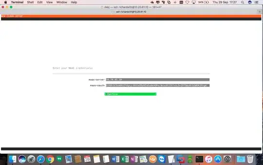

$: conjure-up openstack
to begin the deploy

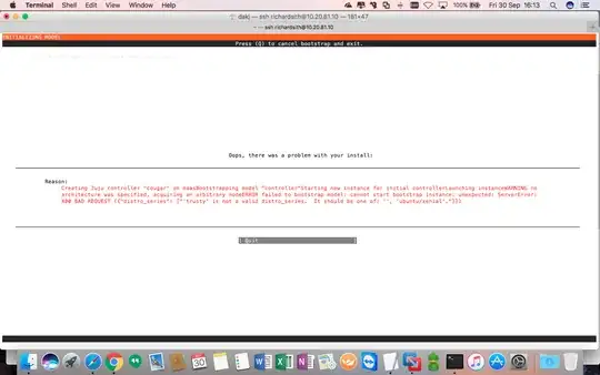

but in this step receive this error

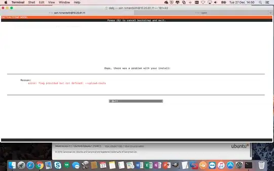

after to update of OS if I re-run that receive the following error
maas-server field needs to be the MAAS server URL i.e. http://IPAddress/MAAS/ and simply NOT the the IP/Hostname.
Also, if credentials are entered incorrectly ever, then ~/.local/share/juju/*.yaml should be deleted/moved.
