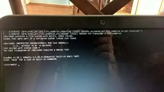

I have a problem while starting ubuntu,
When I start my laptop this appears on my screen
What should I do?

Give a look at this post.
Briefly, the first suggestion is to run
fsck /dev/sda5
and then reboot.
