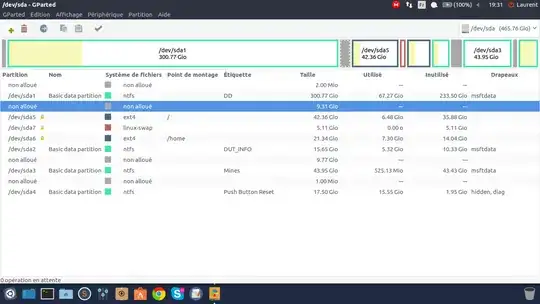

I would like to increase my /home partition but I can't find right manipulation to do it (I know I need to use gparted live cd) but when I try yo extend the /home partition, there is no disk space available.
Can someone help me and tell me the right manipulation to increase the /home partition ?

You first need to move your partitions around so that the unallocated space is immediately after your /home partition; only then can you expand it.
Note that moving partitions is a risky and lengthy process, because the data must be physically moved on the disk. Back up your important data, and grab a good book.
