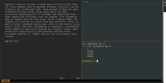

Here is a .bash_aliases function that opens up a tall pane on the left and splits the right pane vertically (see picture below).
"-t $SESSION:1.2" indicates you want to execute the command in the "work" session, in the first window, in the second pane (<prefix + q> lists pane numbers).
"G" is the vim command that takes you to the end of the file.
openSession () {
WORK_DIR=&quot;~/projects&quot;
SESSION=&quot;work&quot;
tmux kill-session -t $SESSION
tmux new-session -d -s $SESSION
tmux split-window -h -t $SESSION:1.1
tmux split-window -v -t $SESSION:1.2
tmux send-keys -t $SESSION:1.1 &quot;cd $WORK_DIR &amp;&amp; vim notes&quot; Enter
tmux send-keys -t $SESSION:1.1 &quot;G&quot; Enter
tmux send-keys -t $SESSION:1.3 &quot;cd $WORK_DIR &amp;&amp; ll&quot; Enter
tmux attach-session -t $SESSION
